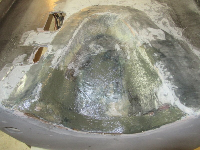

So about 6 this morning I glassed some places I ground through, plus anything else that seemed week. 2 hours later it's almost set up, but not quite.
I have a plan now. A few depressions need to be filled with short strand filler. Once that sets up, I will mix some more resin and lay fiberglass cloth out as smooth as I can. I may stop there, or once that sets up, skim with body fill. One step at a time.

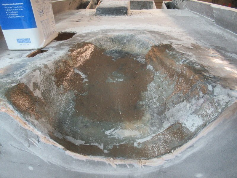

Trans tunnel closer
If no one is interested in my progress here, just let me know and I'll stop posting pics.
After a bit of sanding yesterday, I filled low areas with short strand filler and smoothed it out. A bit of sanding, and I'll be ready for more resin and cloth to get ready to finish this baby off. Can't do that until it warms up Wednesday or Thursday. That's okay, we're leaving this morning, and I won't be back till Tuesday anyways. Once the cloth is done, then it's some regular fill to smooth the cloth out, then should be done.

Trans tunnel
Almost done with this fool thing. A bit more fill, then fiberglass resin and cloth.
