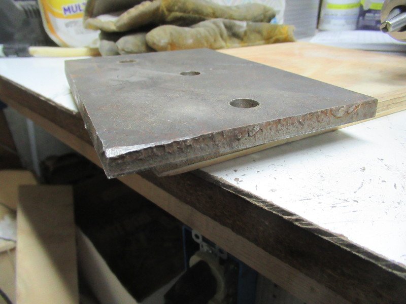

I do think I figured out how to mount my drill press for engine turning. Still need a few more things, and could use some advice from Mike Wade. The tube that goes in the drill press is about 1-3/4 inch (OD). I can get 1-3/4 inch o.d. pipe at NAPA to extend it. How long Mike?

You just need to be high enough to slide the alum
Under. What ever higher you need will work.

Got it figured out. Will bolt this heavy duty structural steel with 5/16 bolts to 3/4 inch MDF backed by washers of good multi-ply 3/4 inch plywood with 1/4 inch steel plate for a washer. Should work fine, but will have to build a movable table for in front of my 24 inch workbench.

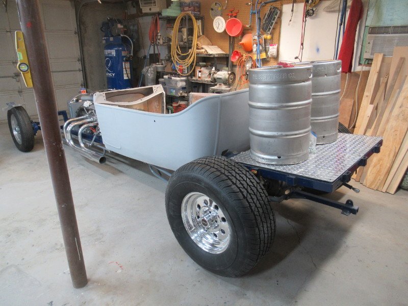

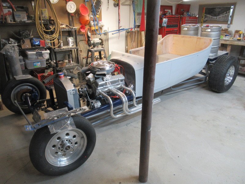

Few pics of where I am today. Got pretty much all I need to finish but help. Takes a long time to do this stuff when you're handicapped and on heavy duty drugs and working all by yourself. Not to mention how lonely it gets. So it goes. I want a hot rod!
So these are my new rear wheels and tires. What do you think of the rake? I think it looks okay.

I like the stance of your T, Frank. The whole car is looking great! What's the wheelbase? Have you decided on a color for the body?
