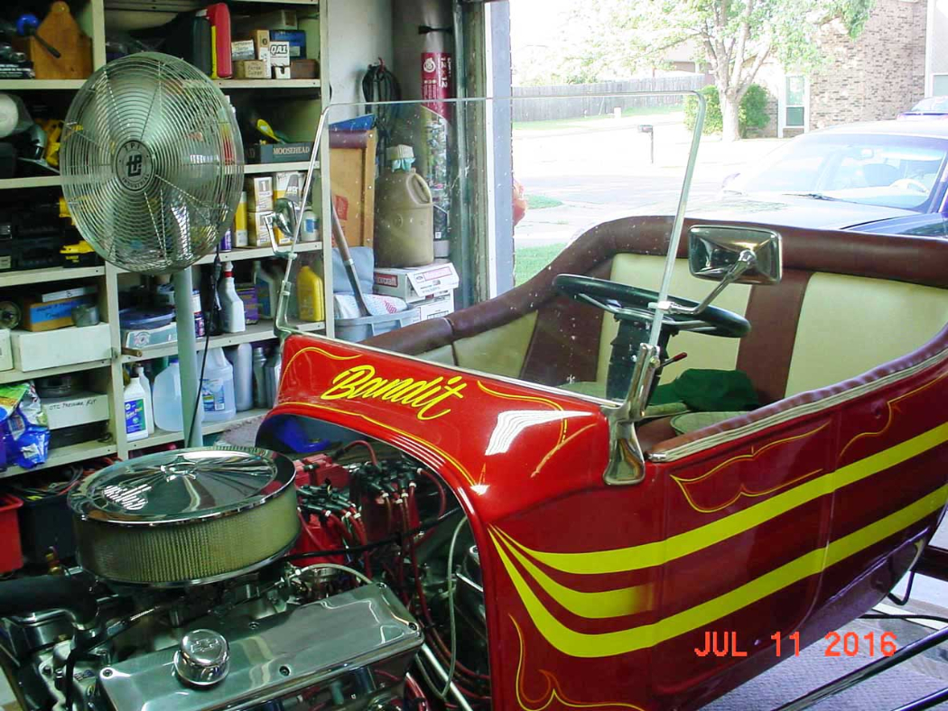

I'm using 3/4 inch Lexan without any frame or suppoprts, it's 19 inches tall. I've had it to
108 mph without a problem. I did take the trouble to fit the windshield post like a glove to
the body to spread the forces out. Another advantage is mounting mirrors, they can go
anywhere you like.
