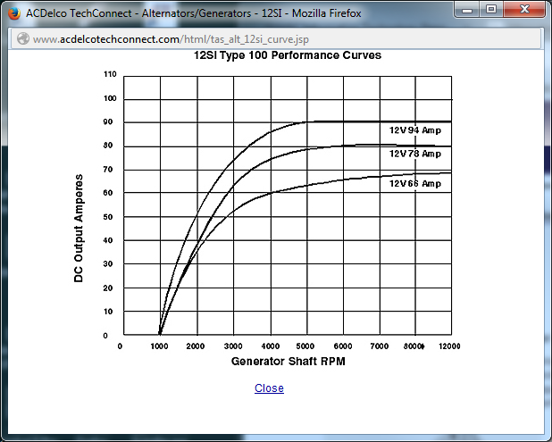

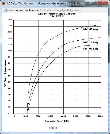

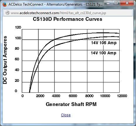

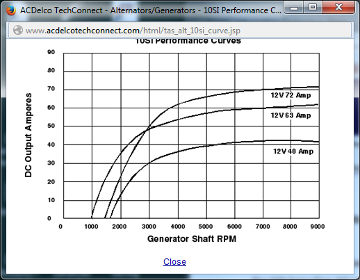

Re: 1 wire or 3 wire alternator
The Long Way To A Solution
First you need to add up all your loads and add them up to see what your total will be. To help
I have included a table with many of the loads included. Now these are only approximate and
especially the radiator fan seems low. I know mine is supposed to draw 30 amps at full speed,
it’s a 16 inch and has a rating of 2500 CFM.
The problem you might encounter is the alternator puts out the lowest amount of current (Amps)
when the loads are at their highest. Picture this ……Your radiator is barely keeping up, it’s at 210°F
and your thermostat is a 180°F, it’s night time and your light are on, your turning so your signal
are flashing and the brake lights are also on while you wait for the light to turn green. Besides that
you also have an electric fuel pump and the fan is running at full speed, full speed for 12v and not
full speed for 14.4v. Therefore the fan is running at a reduced speed and now the engine is starting
to overheat at 220°F and traffic won’t get out of your way. It’s 230°F now and climbing, what will
you do in this situation. If I had just put the bigger alternator on so my fan could run at its designed
full speed, maybe I wouldn’t be in this situation. Also my headlight wouldn’t get brighter every time
the engine RPM picked up either.
To keep from getting in the above situation, know your load and the output of your alternator at idle.
Use the graphs below and determine alternator output at idle. Note that the graphs are at the
alternator RPM, not the engine. The alternator turns 2.5-3.0 times faster than your engine. To know
exactly, measure the diameter or circumference of the crank pulley and divide that by the alternator
pulley. Multiply that number by the idle RPM.
This way is of course the long complicated way of doing this, or you can just buy good size alternator
and be done with it and hope for the best.
Below are some typical loads:
Three wire alternators are a little better in my opinion, but if you don't have time they can be wired to
function just like a one wire alternator.
http://www.madelectrical.com/electrical ... wire.shtml
