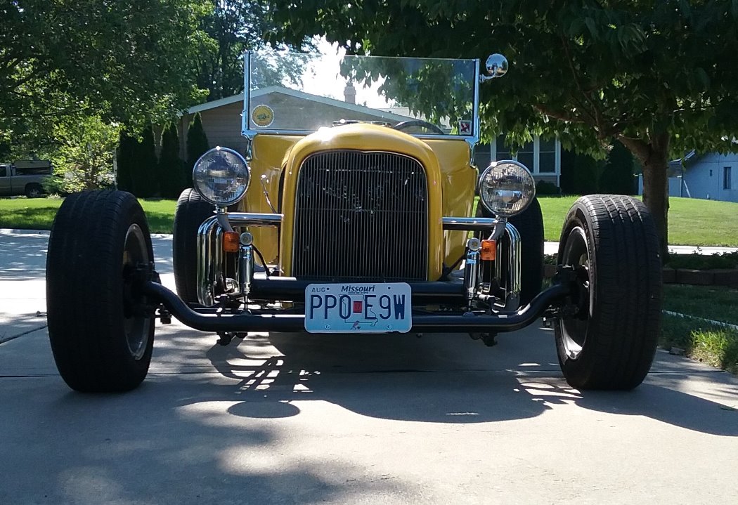

I notice the outside tread of my front tires is wearing more than the inside. I also see a slight positive camber in my front wheels (about 1 degree each wheel with my angle finder). Is this correct, and if not is it something that can be corrected without bending the front axle?
PS - My toe in is about 3/32" the last time I checked.

Hey Spanky, can you post a somewhat close up of the whole front end, looking straight at from the front.

Re: Tire wear
Like this?

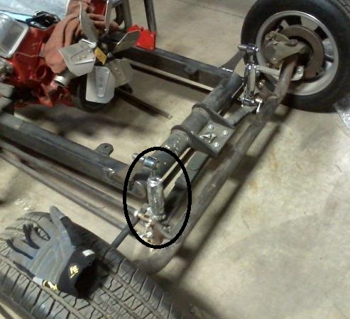

'Cuz I like 'em like dat! :mrgreen: Originally I had 'em the other way . . . (see below)
9 front axleb.jpg (68.31 KiB) Viewed 1330 times
(PS - They work just fine in the 'upside down' position!)

Bill Cleveland wrote: Tue Jul 10, 2018 10:22 am Like this?
Yep that should do. I see the drag link is behind the axle, not a big deal. what I was wondering before the photo was the Ackerman angle. It appears to be ok without actually being there to test for it. Based on that I am going to guess the axle may need to be bent to correct the camber. when I bought mine 25 years ago the Ackerman was way off and did wear the outside of the tires real bad. I corrected it and no more problem. I would think you guys have someone in St Louis area who could bend the axle???
