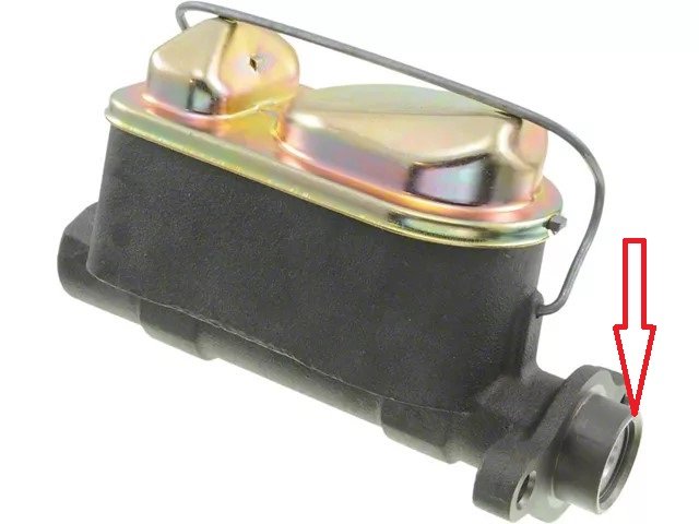

Since most of the master cylinders on a T-bucket are located under the car, is there a dust cover made to keep water out of the back of the master cylinder or is just left open.

Most MC's that I know of do not have any opening that water could enter. There is a rubber boot where the pedal actuating rod enters the MC, but again not a concern for water entry, unless it is torn or missing. Here's what I am using . . .

Bill what I was referring to is the open area where the push rod from the brake pedal enters the piston.

Bill Salser wrote: Mon Mar 09, 2026 10:21 am Bill what I was referring to is the open area where the push rod from the brake pedal enters the piston.
Bill on any master cycl I know of, if it was taking on water from outside you will first have a Brake Fluid leak that it would then take on water only after the fluid was gone............. :)! :)! :)! :)!
Again, there should be a rubber boot over this area, and like Mike said, little chance for water ingestion as long as there is fluid in the MC.

The rubber boot is what I was asking about as I have not been able to find one, so I wondered what everybody else was using.

Bill Salser wrote: Tue Mar 10, 2026 11:16 am The rubber boot is what I was asking about as I have not been able to find one, so I wondered what everybody else was using.
Bill in all my years of driving T Buckets and other cars with no cover on the rod I have never been able to see where the water can get into the Master that way........Again if it is full of Brake Fluid it will make a leak long before it will take on water.......... 8-) 8-) 8-) 8-) 8-) 8-) 8-) 8-) 8-) 8-) 8-) 8-)
