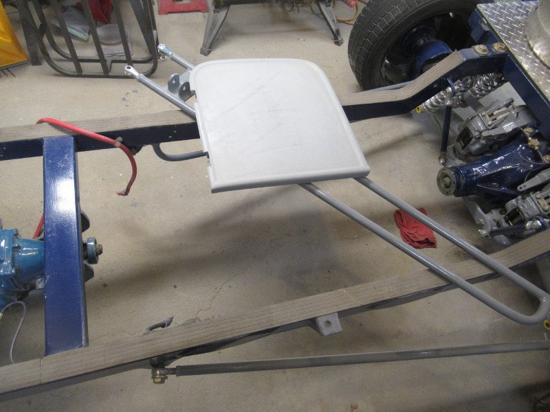

This is a test to see how this drag and drop a picture works...
- driveshaft.JPG (113.62 KiB) Viewed 839 times
frank_a
- Posts: 505
- Handle: frank
- Location: Oneida NY
Re: Driveshaft?
Ha ha ha! Kept trying, did not see a pic. Guess this drag and drop thing works! Thanks Lee!
This pic is with my engine and tranny in position and the old Jag IRS installed. More pics later, gotta run.
Frank
Frank

Looks like 41 and 7/8 to center of yoke. Also, maybe next month have new wheels and tires for the back too. I hope...
