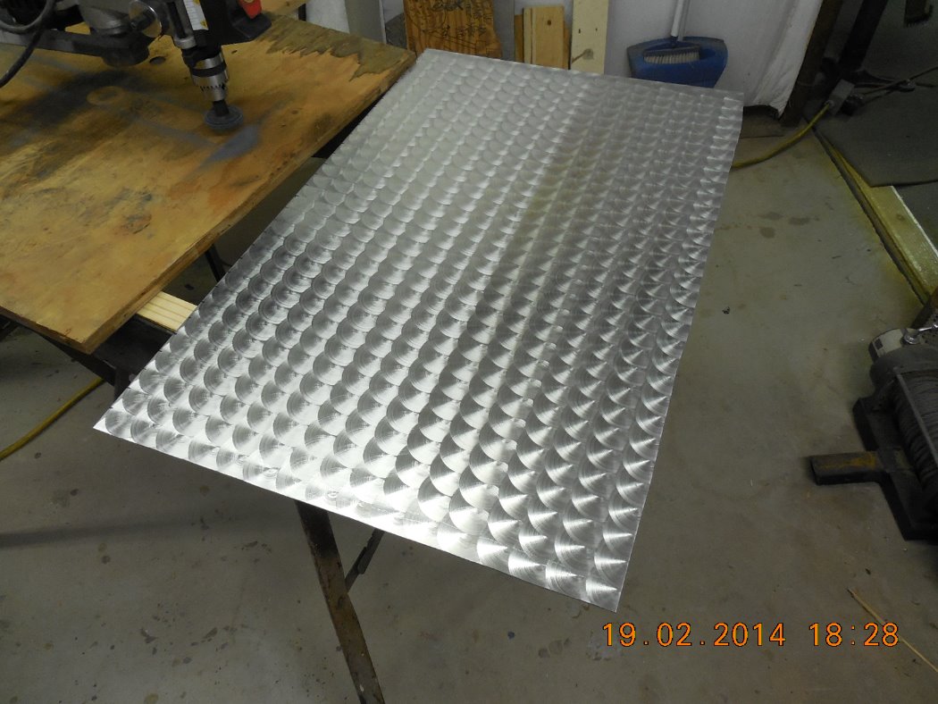

Hmm. Firewall too eh Mike? Nice idea!

frank_a wrote: Mon Feb 11, 2019 10:21 am Hmm. Firewall too eh Mike? Nice idea!
T B 2-19 003.JPG (197.1 KiB) Viewed 1020 times
Re: Removable dash?
The trickiest part Frank is getting that drill press to levitate without a support post. LOL :lol: :lol:

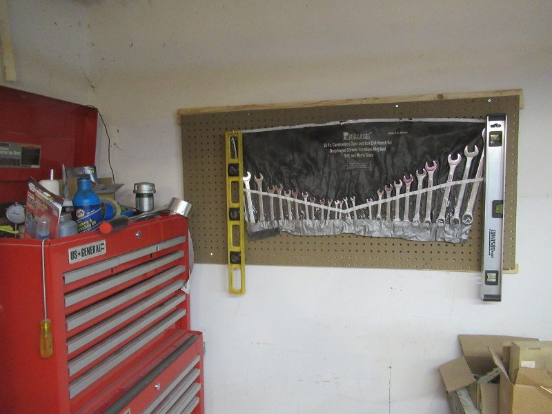

Put up a new piece of peg board today for a wrench pouch I've had for an awful long time. Took advantage of the peg hooks to hang a few of my smaller levels. That box on the lower left of the pic is on one edge of my rolling worktable that is chock full of fasteners.

Mike Wade, what kind of tool is that you used for your engine turning?
Posts: 5046
Re: Removable dash?
frank_a wrote: Mon Feb 11, 2019 7:07 pm Mike Wade, what kind of tool is that you used for your engine turning?
Frank I took my small drill press and made a tube from an Alum shaft that would fit my drill's mount and that slipped it in to a pipe that is welded to my table on my saw. That was I could get that whole sheet under the drill. If you look real close you will see a couple marks on the back rest that was used to mate up to the one on the sheet of Alum on 2 inch centers. That is how you get the pattern.....Clear as mud I know.....
After awhile the circles will cross your eyes so I only made about 3 pass at a sitting.... :)! :)! :)! :)! :)! :)! Try it you will love it..

https://www.youtube.com/watch?v=Gn2uojIp3Jw
Here is the video we took when I did this project. Bill Darr was the camera holder......LOL...Frank I hope this helps. :)! :)! :)! :)! :)!
Re: Removable dash?
Hi Frank,
I did my firewall and dash also, 1" diameter on the firewall and 1/2" diameter on the dash. Stainless steel on both :)!
I used CRATEX rubber abrasives to do mine. I used a large throated drill press with a homemade jig and fence.
