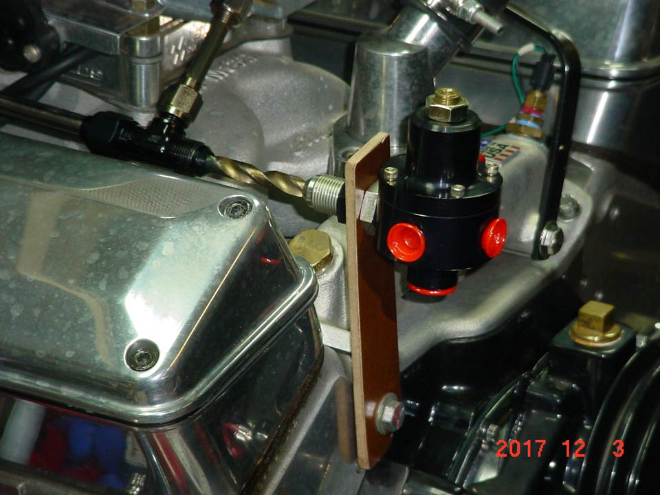

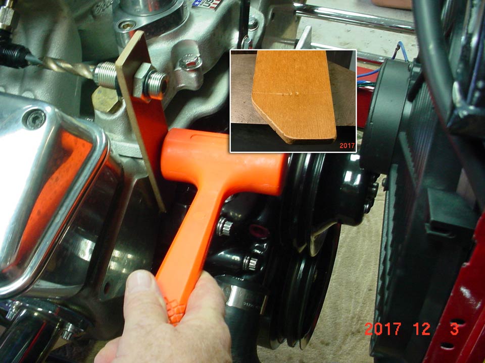

I'm using wood, since it's much easier to make mistakes on a soft material like wood. Now
that I can see all the mistakes I made, it should be much easier to make the correct one
from steel. I did buy some 304 SS, but I don't have a drill press that will turn slow enough
on the bigger drills. I will probably just use some steel flat bar from Lowes.

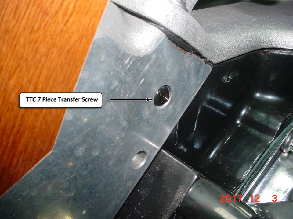

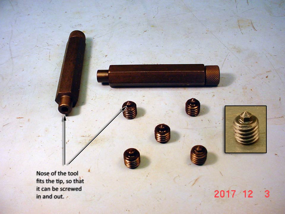

To upgrade my fuel system. I started with the bracket and location of the pressure regulator.
I bought a tool 2 years ago and finally have a situation to use it. I used it for only one hole,
but where it really shines is precisely locating multiple hole at one time. It would be
impossible for the home shop to get all 5 holes located in a bracket, but with this tool it
should be NO problem.
https://www.amazon.com/gp/product/B00B4 ... UTF8&psc=1
Sure enough it screwed together in perfect alignment without any coaxing and without any
choice words. There would have been no way to measure accurately, I would have had to make
the 2 holes bigger than needed to make it align.

AHHH, Transfer screws, love em, VERY handy little tool , I use to use them frequently as a die maker.
