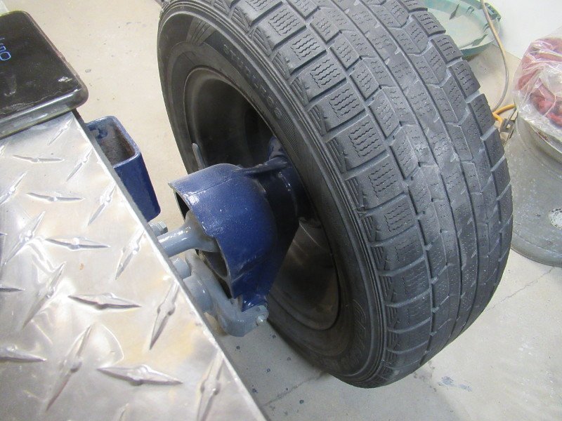

Well folks, I did a bunch of measuring, and also took some pics.
Where the body will meet the tires it's 44 inches wide. It will not meet it for most of the tire, only 4 to 5 inches, but nevertheless it still has to clear!
Right now junkyard wheel to wheel is 53 inches. The wheels have a backspace of 4 inches and the tires are 7 and 3/4. I think the 5 and 1/2 inch wheels with tires that are 10 and 1/2 wide will clear. No problem with the stake rack.

- Bruce Pickett
- Posts: 623
- Handle: T-Test
Re: How to figure back space?
Can you show a side view of the car as it will be with the body on the frame?
Thanks for taking the time to measure and take pictures. Well done!
Your measurements of 53" from wheel to wheel plus 8" of backspace (two 4" wheels) is 61" so that should be sedan rear which is just a bit over 61". 61" minus 11" of backspace (two 5.5" BS wheels) is 50" which should give about 3" per side clearance for the 44" wide tub.
Bruce, I may get it on the chassis later today, and would be glad to take a pic.
Dezolde, thanks man! That's pretty much what I figured, i.e., there would be room. It is a sedan rear - I know, because I took it out of the sedan! I'll see if I have some pics of my old hot rod, and the new one with the body on.
