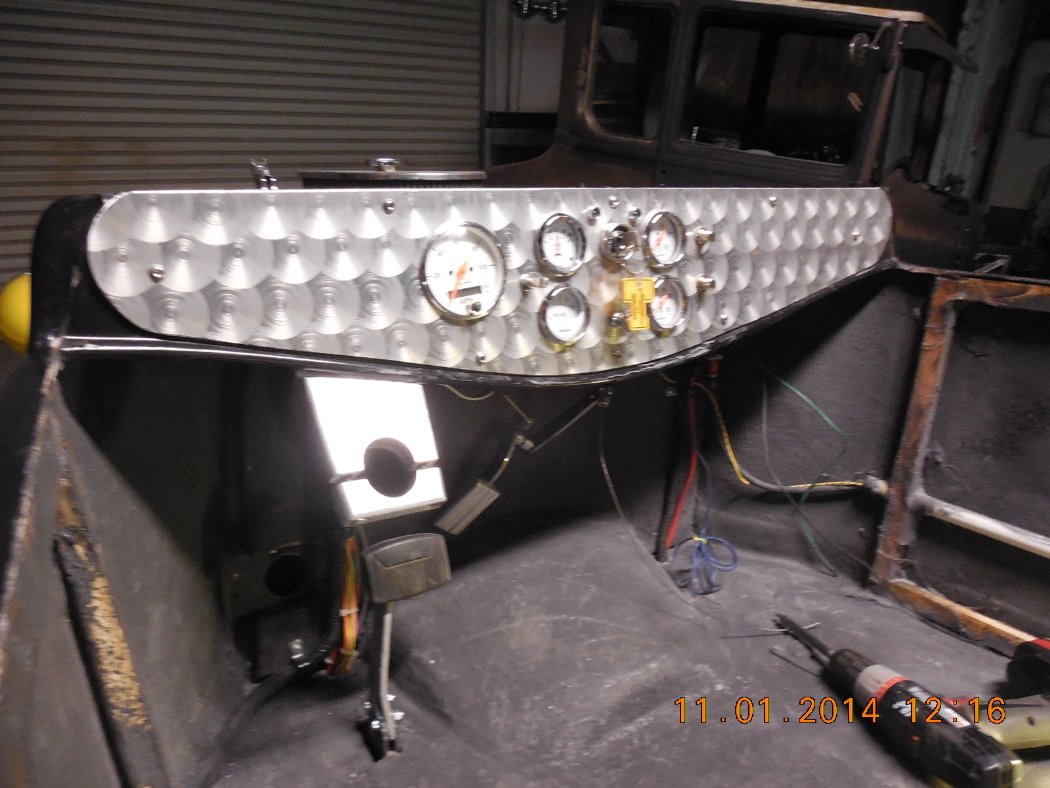

Like this dash.....

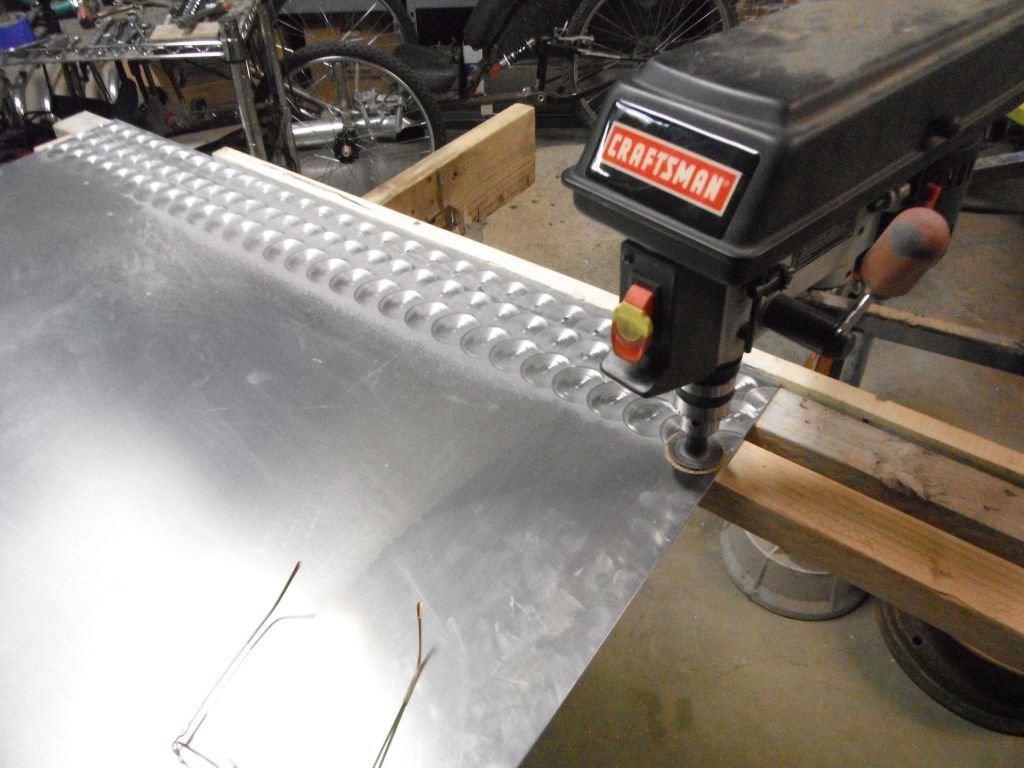

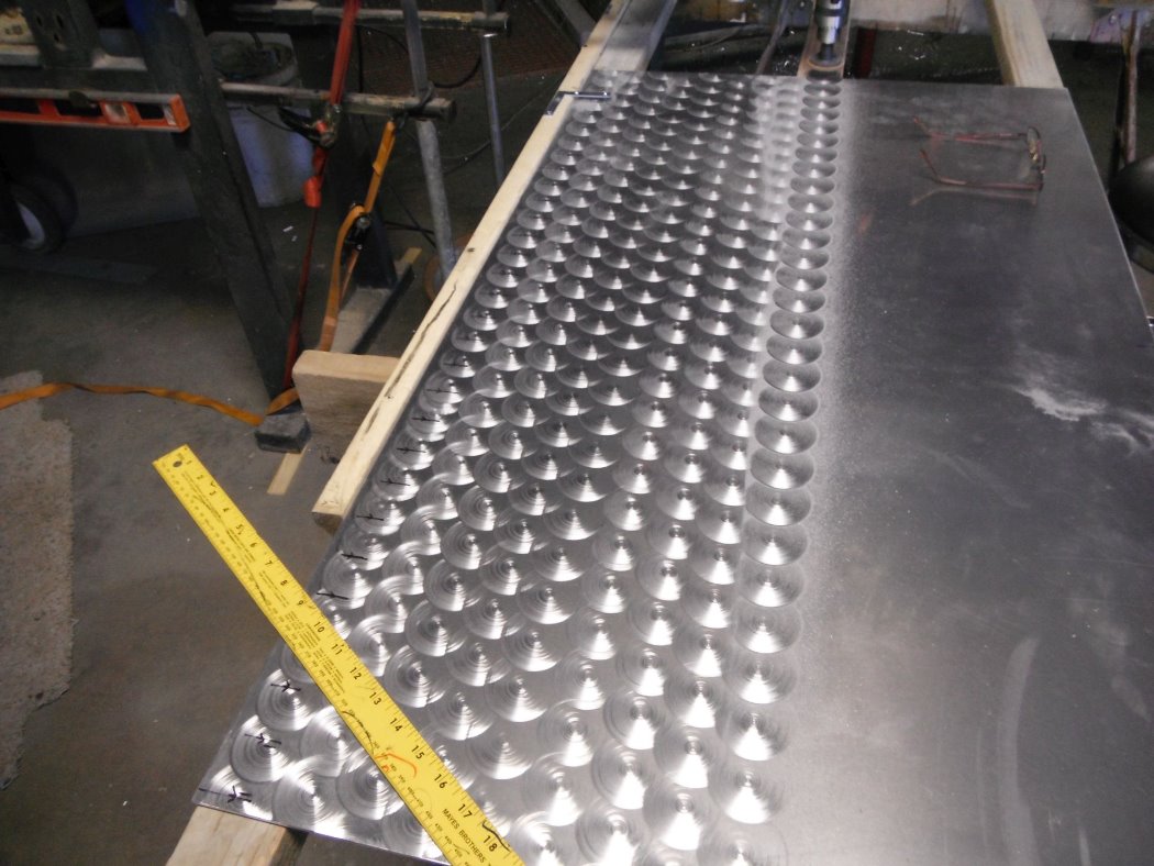

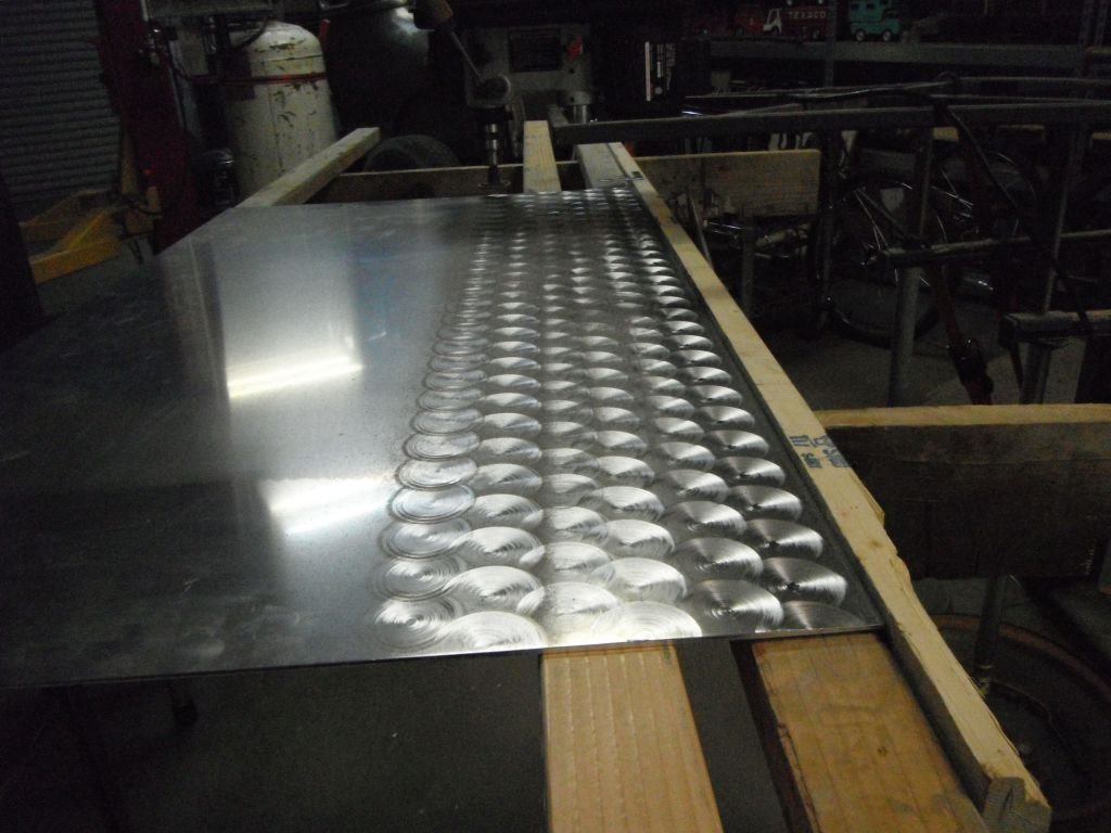

Frank Let me look to see if I can find my crude engine turning set up. I use my small drill press and some Roloc pads..... :)! :)! :)! :)!
Posts: 5046
Re: Removable dash?
OK this is what I did for my engine turned parts...…... :)! :)! :)! :)! :)!

Very nice Mike. All I want to do is my dash. I'll experiment with some of my wide variety of Rolocs on my big multi-speed floor mount drill press to figure this out. Will check on the price of a piece of aluminum big enough to do the dash, and see when I can get one. Thanks man.
Posts: 5046
Re: Removable dash?
frank_a wrote: Mon Feb 11, 2019 9:04 am Very nice Mike. All I want to do is my dash. I'll experiment with some of my wide variety of Rolocs on my big multi-speed floor mount drill press to figure this out. Will check on the price of a piece of aluminum big enough to do the dash, and see when I can get one. Thanks man.
Yes Frank I do this on smaller pieces all the time. These were done for the Firewall & the Dash & the bed cover so I set it up this way.....I just did one for the "C"edan I am building now...…. :)! :)! :)! :)!
