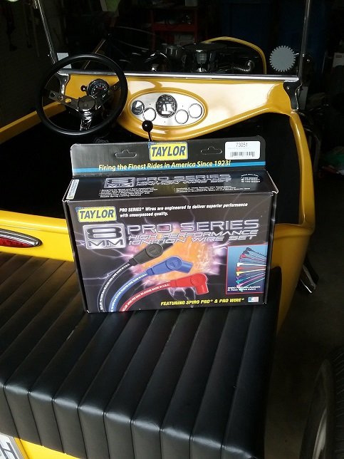

OK, so I downloaded an article from ACCEL and they say, "Do NOT use solid metal core spark plug wires" with breakerless distributors!
So . . . I ordered these:
Posts: 5050
Re: Spark plug wires
That is what I try to use all the time........Good Choice........Don't listen to Uncle Larry he is old and senile..... :)! :)! :)! :)! :)!See Uncle Larry this kid loves me.... :lol: :lol: :lol:
