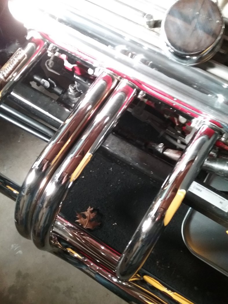

The angled plug heads provide a little more room for some types of headers, but there is no real performance advantage for either one. I am using straight plug Vortec iron heads on my 350 Chevy with Patriot "classic style" T-bucket headers. No problems.
new hewaders.jpg (160.56 KiB) Viewed 715 times

Bill Cleveland wrote: Wed Mar 24, 2021 2:53 pm The angled plug heads provide a little more room for some types of headers, but there is no real performance advantage for either one. I am using straight plug Vortec iron heads on my 350 Chevy with Patriot "classic style" T-bucket headers. No problems.
Just looked these up. (These are among the ones I found in my research)
Seller, Speedway, states..."Fits most angle plug heads". To me that means does NOT fit straight plug. But looking at them, how can they not fit?
Looks like there is plenty of clearance for straight plug heads.
Thanks for confirming these will work.
