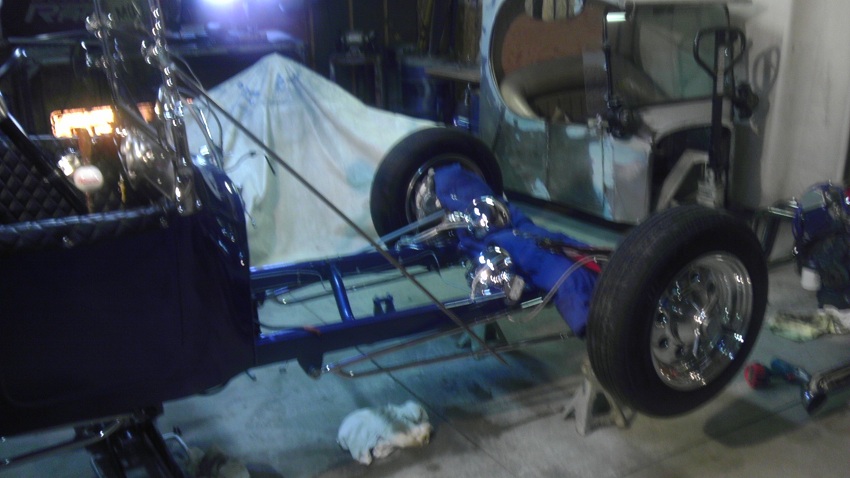

Guess what I am doing for my Holiday weekend
Can we say New Flex Plate motors out and going to Reno in the morning to get a new one

Mine was self inflicted the timing was off ( has been for a while ) and would Kick back sometimes I should have set the timing now I have 4 teeth missing in one spot
now I have to fix it I just got Lazy and now paying the price
