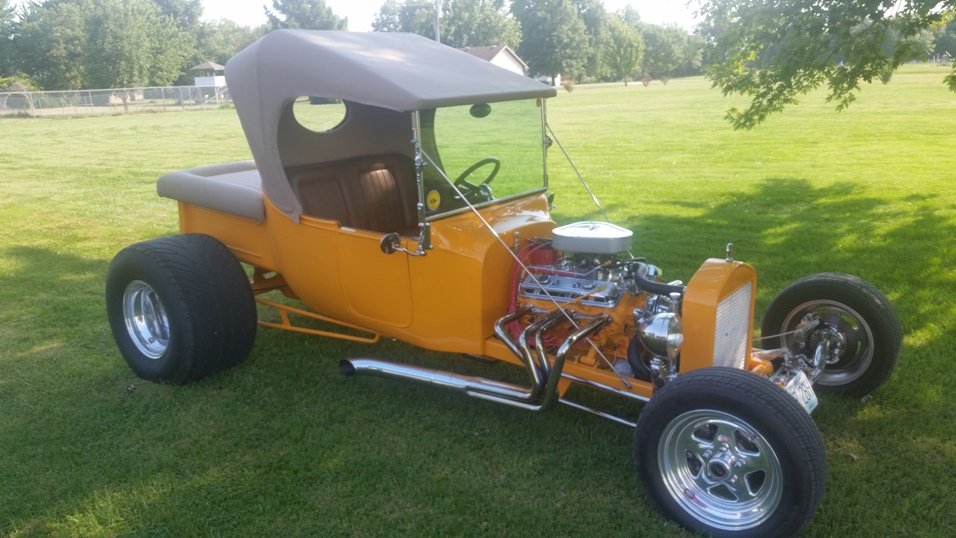

After 3 1/2 years I ended up with a complete car.
Moral of the story is ...Don't Give Up!!!
It's a journey.
Copy (2) of 20170913_101834.jpg (115.04 KiB) Viewed 363 times

Dennis Neblock wrote:
Thanks for the caption Spanky! Good job.
It's a journey.
It is a journey (see thread title :) ). Nice Bucket, good job.
I don't think I have ever given up, but yes I did have to stop, rethink, and come up with a different way to do this. Even now it's far from ideal and things are so hard to do that It's not going to be fun... but I'm doing it and the end result will be the payoff and enjoyment.

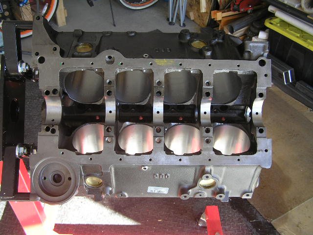

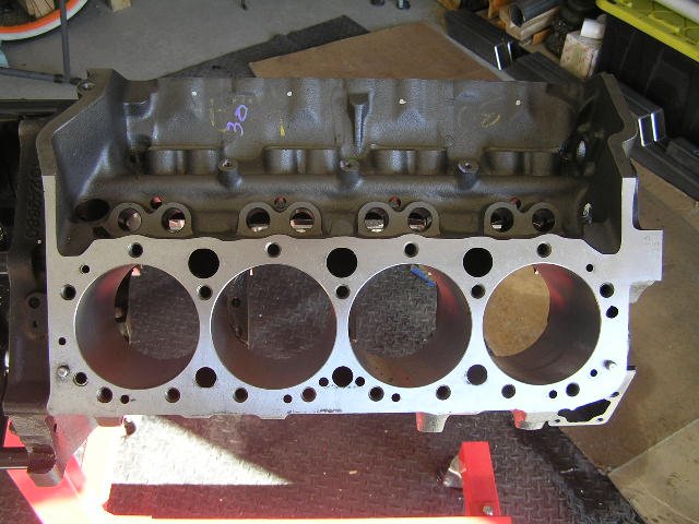

This build is happening in parallel, the rolling frame / body... and the engine. Goal is to get both finished at the same time. I'd hate to have the T done and have to wait months for the engine to be done. Anyway, we'll see how the plan goes.
Here is a start of the engine build. It's a 1996 -2000, 4 bolt main, one piece rear seal, factory roller cam, 0.030 over bore. All machine work done, including clearancing for the stroker crank. Will be 383ci. I need to strip the new black paint and redo in the correct color... which I will do soon.
Please excuse the clutter in the background.

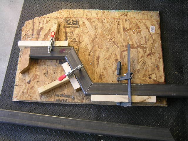

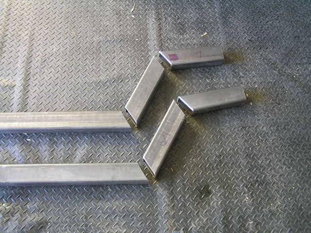

Today I took some steel to my welder guy. Progress has started.
