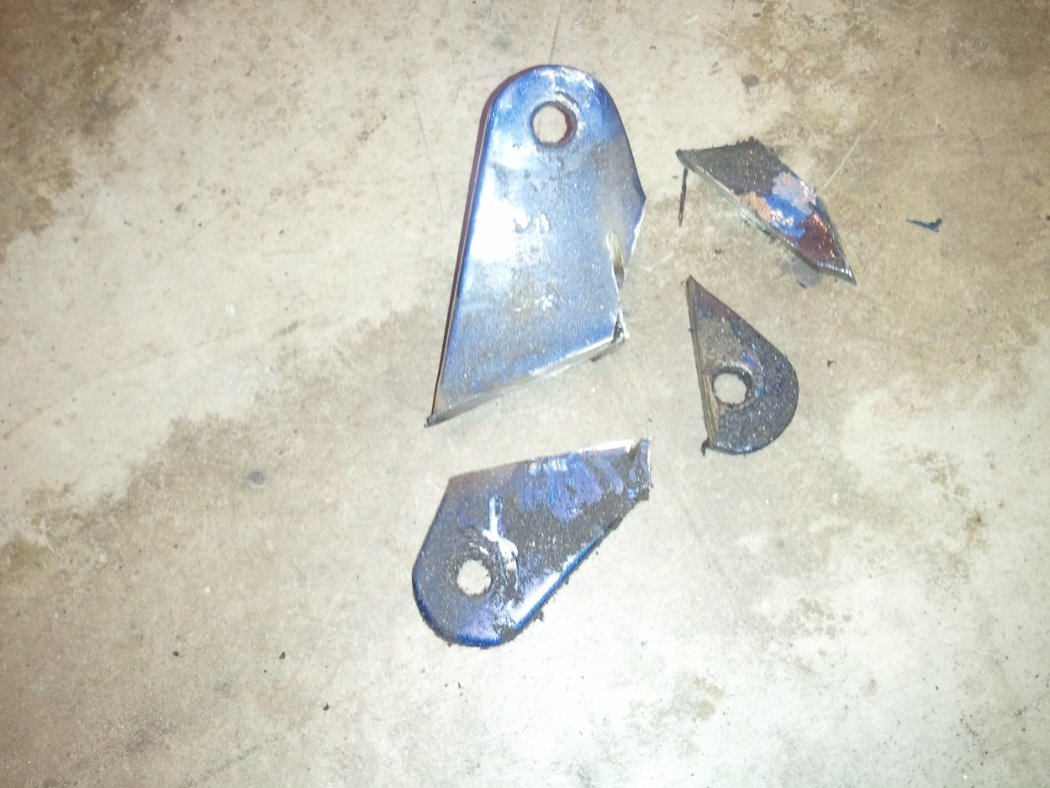

ok I went on e-bay and typed cross steer half rack and a bunch show up. once I got it I took the mounting bracket off because that is designed to replace a vega steering box
VroomKrazy
Posts: 991
Handle: VroomKrazy
Re: Rack & Pinion Steering
Then cut off the old covair steering box mount

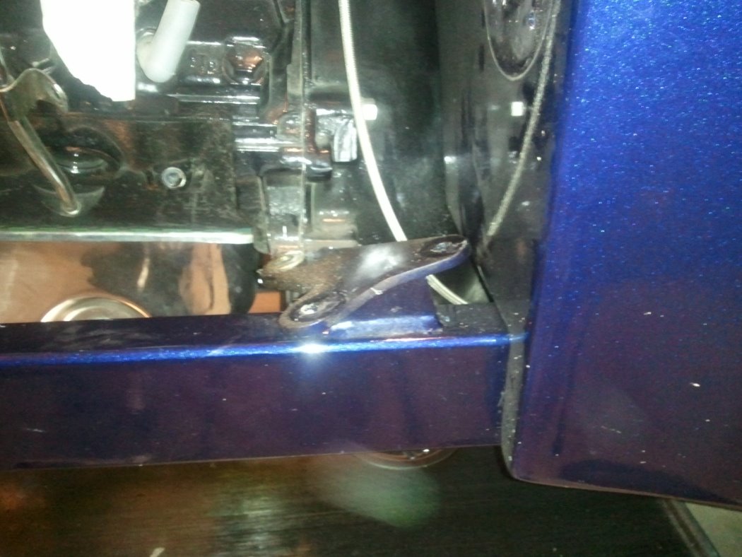

I do not have a lot of picture of this, but what I did was take a piece of the same tube the frame is made of and cut it to make an angle. then I made a mounting plate and tacked it in place a few time to get it at the correct angle and in the correct place so the drag link was parallel to the radius rods, and the u-joints would turn.
VroomKrazy
Posts: 991
Handle: VroomKrazy
had drag link cut to size and tapped. then bolted everything back on and now it steers like a go-kart. :)! :)! :)! :)! hope this helps

Use Paul's photos because the end results is about the same...…..He had to remove the Corvair mount because it was on top of the frame......In my case I used the old mount to hold the Hiem Joint that supports the u joints because it was on the inside of the frame...…….All of these are just a bit different but the results are the same...….
Now lock to lock is not much different from Corvair but you do have a shorter turning radis going to the left but like Paul says it will go where you are pointing the car...…..Try it you will love it.... :)! :)! :)! :)! :)!
