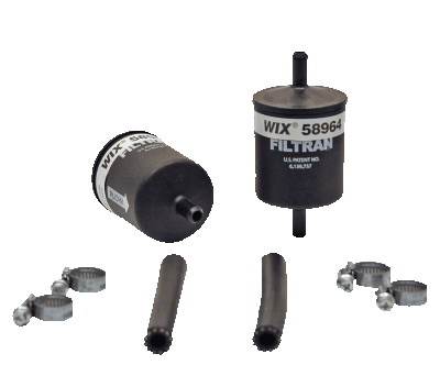

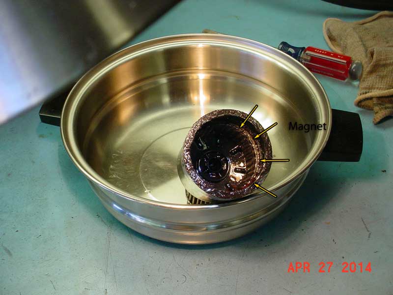

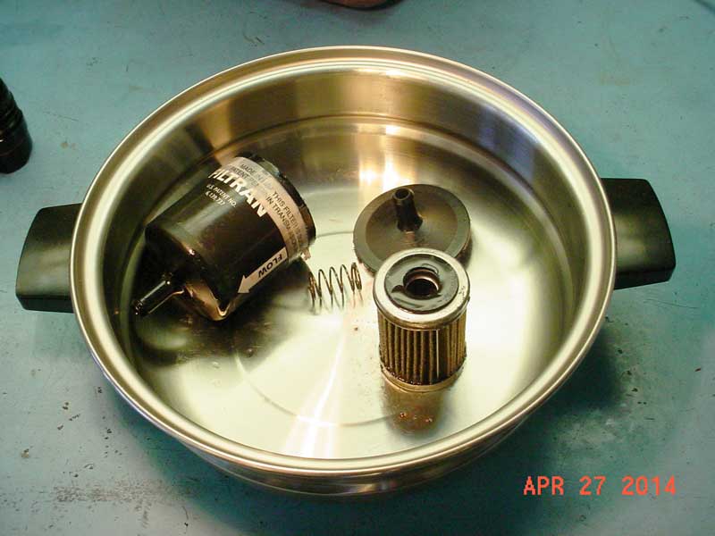

If you are running a trans cooler, could be in the radiator or an external one. You will
need to flush the lines and cooler. Would also be a good idea to put one these Wix
magnetic inline filters.
https://www.summitracing.com/parts/wix-58964
https://www.youtube.com/watch?v=5TlslgFytYE
https://www.summitracing.com/parts/tci- ... DREALw_wcB
